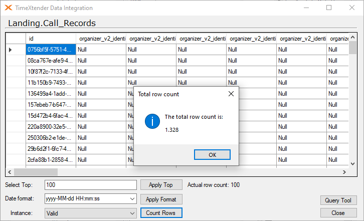

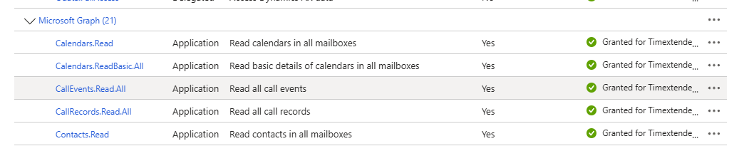

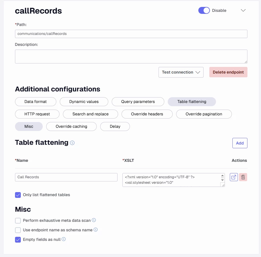

Hi ​@r.miltenburg
I had to allow for the right on my app to be allowed to use it.
This is my endpoint setup.
I get this result.
