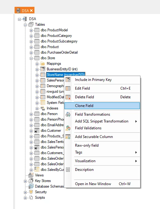

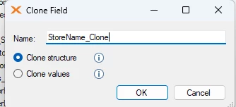

Cloning a field
All fields a data warehouse or staging database can be cloned, no matter if they are brought in from a data source or added later.
To clone a field, follow the steps below.

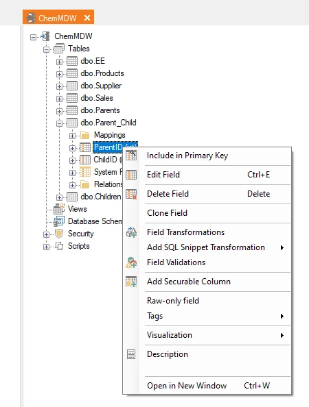

  1. Right click the field and click Clone Field.
    The Clone Field window appears
  2. In the Name box, enter a name for the field.
  3. Two options are available:
    • Clone structure: The cloned field will be an exact copy of the original field including transformations and validations
    • Clone values: The cloned field will be a custom field that gets its value from the original field.

  • Right click the field and click Include in Primary Key.

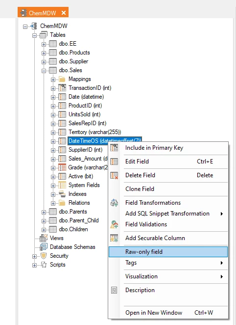

Hiding a Field from the Valid Instance of a Table (Raw-only Fields)
A raw-only field is a field that only exists in the raw instance of the table and not the valid instance. When a field is designated as a raw-only field, it will not be displayed in SSAS Multidimensional cubes, Qlik models and other front-ends that use the valid instance of the table. This can be beneficial when for fields in the table that have no other purpose than to be part of other fields, for example a surrogate key field that is used to implement dimensional modeling.
To make a field raw-only
  • Right click the field and click Raw-only field.

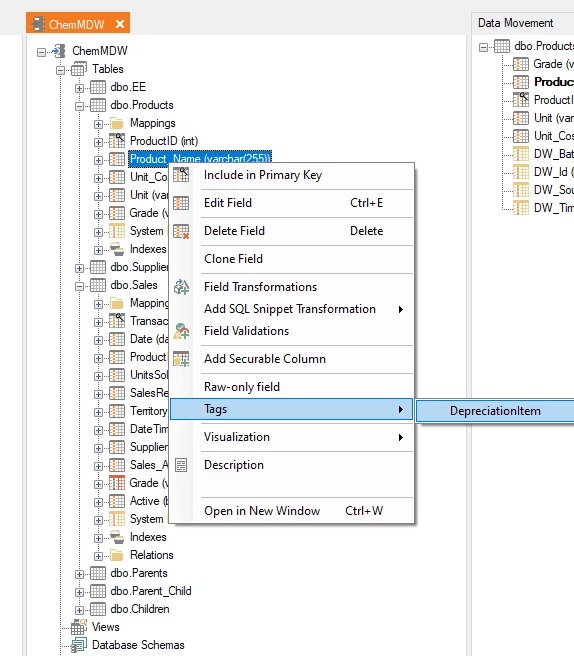

Tagging A Field
Fields in a data warehouse or staging database can be tagged. These tags can be used as the basis for project perspectives and for the data impact documentation type.
If  tabs are added to a field to help create data impact documentation, then it is important to tag the fields as "early" as possible, i.e. in the staging database. Tagging done in this way will help delineate  the entire journey of the field data from the source to the endpoint as captured in the documentation.

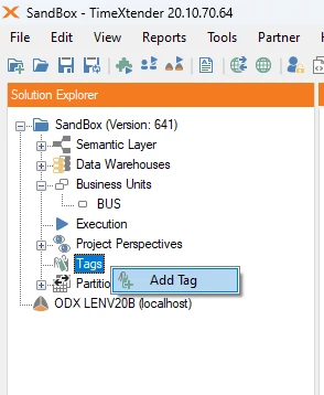

Before you can add a tag to fields, you have to add the tag itself.
To add a new tag
  • Right click Tags in the Solution Explorer and click Add tag.
    Name the tag and click OK.
Once you have added one or more tags, you will then be able to add tags to fields.
To add a tag to a field
  • Right click the field, click Tags and click on the tag you want to add to the field.

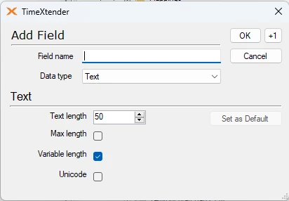

  1. Right-click a table and click Add Field. The Add Field (Add Custom Field) window appears.
  2. In the Field name box, type a name for the field.
  3. In the Data type list, click on the data type you want to use for the field.
  4. Define the attributes of the selected data type. You have the following options:
    Data Type Attribute Description
    Text Text length The maximum number of characters the field can contain.
    Max length The field can contain any amount of characters up to a storage size of 2 GB.
    Variable length The field can be of variable length.
    Unicode Characters are encoded in Unicode
    Integer Type The size of the integer: bigint, int, smallint, tinyint.
    Numeric Numeric precision The number of digits in the field.
    Numeric scale The number of digits to the right of the decimal point
    Mantissa bits The precision of the floating point number if floating point is selected. 1-24 bits equals single precision, while 25-53 bits equals double precision.
    Floating point The number is saved using floating point notation.
    Binary Length The length of the binary field.
  5. (Optional) If you want to use the same attributes the next time you add a field of the same type, click Set as Default. The default the button is disabled, the current settings are the default settings.
  6. Click OK to add the field and close the window or +1 to save the field and add another field.

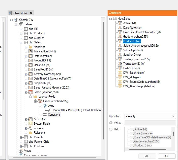

Adding Conditions to Lookup Fields
On each lookup field, you can add conditions for when to use that lookup field. The lookup will only be performed when the condition evaluates to true. For example, if you can determine that the lookup will only find related values when a certain field in the destination table has a certain value or apply a condition to avoid the lookup being performed on many records without finding a matching record.
Conditions must also be used when having multiple lookup fields within one conditional lookup field to determine which lookup field to use. Per default, the first lookup field where the condition evaluates to true will be used, even if it returns a NULL value or finds no matching records. If no conditions are specified, the first lookup field will always be used and any subsequent lookup fields will be ignored.
To add a condition to a lookup field, follow the steps below.
  1. Expand the lookup field and click Conditions. The Conditions task pane appears.
  2. Click on a Field in the pane.
  3. In the Operator list, click the operator you want to use.
  4. Click Value and enter a value to use in the comparison in the box
    - OR -
    Click Fields and select a field to use for the comparison in the list.
  5. Click OK to add the condition.

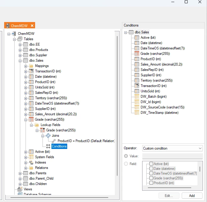

Note: If you select the Custom operator, you can script your own condition. When you drag a field from the list to the right in the script editor, remember to specify if you refer to the field in the raw or the transformation view instance of the table by prefixing the column with "R.[FieldName]" or "T.[FieldName]". If you don't do this, TimeXtender will not be able to tell what field to use and the deployment of the data cleansing script will fail.

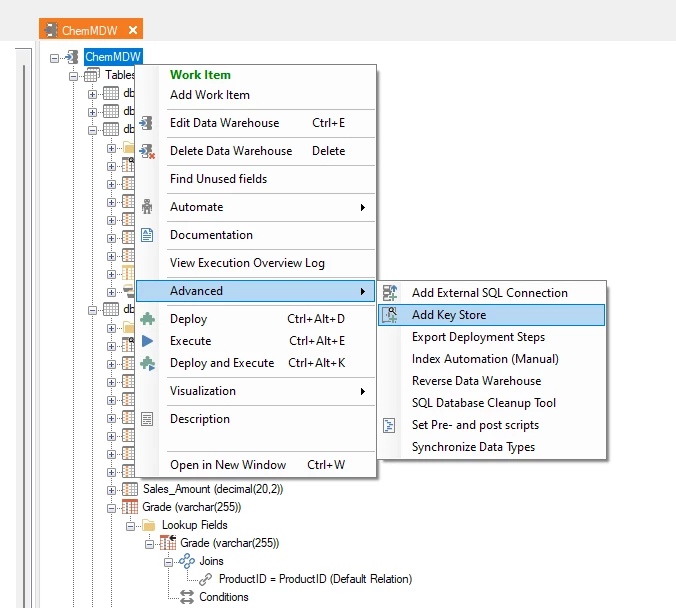

Supernatural Key Fields
A supernatural key is a key that is independent of the natural keys, e.g. customer numbers, that are found in the data and is durable, i.e. it does not change. Since natural keys can change in the source system and are unlikely to be the same in different source systems, it can be very useful to have a unique and persistent key for each customer, employee etc.
In TimeXtender, supernatural keys work like this: When you create a key, you choose some of the other fields on the table to base the key on. These fields are then hashed together and the hashed value is compared to other values in a key store table. If the same hash already exists, the corresponding key value is returned. If the hash does not exist, it is inserted into the key store and a new key value is generated and returned.

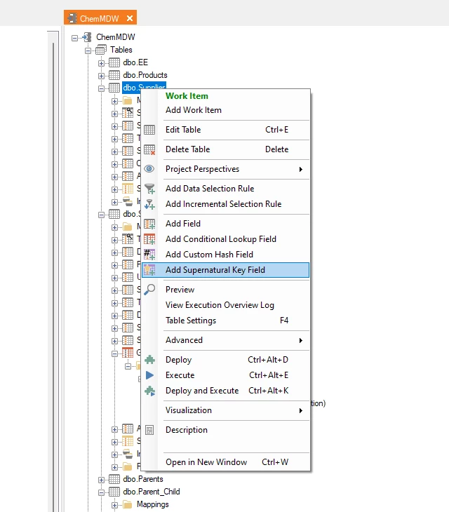

Adding a Supernatural Key Field
To add a supernatural key to a table, follow the steps below.

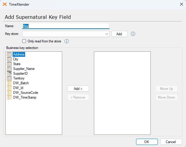

  1. Right click a table in a staging database or data warehouse and click on Add Supernatural Key Field.
  2. In the Name box, type a name for the key.

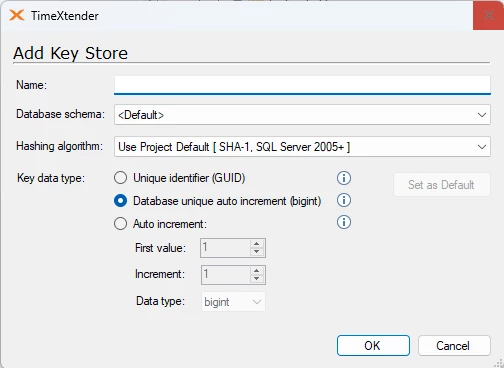

  3. In the Key Store list, click on the key store you want to use
    - OR -
    Click Add to add a new key store. See Adding a Key Store below for more information.
    Note: All supernatural keys that you want to relate should use the same key store. The data type of the field depends on the key store you use.
  4. Select Only read from the store if you do not want to create a new entry in the key store when the business keys do not match an existing entry. The value of the field will be null if no matching key is found. With managed execution enabled, tables with fields with this option enabled will be executed after tables where the option is not enabled. This ensures the greatest possibility of a matching key in the key store.
  5. Under Business key selection, the available fields are listed in the left-hand list while the selected fields goes in the right-hand list. Add the fields you want to base the supernatural key on to the right-hand column.
    Note: The order of fields matter since two lists of identical fields will only give the same result if they are ordered in the same way. Use the Move Up and Move Down buttons to reorder the fields.
  6. Click OK to add the supernatural key field.
Adding a Key Store
Key stores are what ties supernatural key together. You will typically need a key store for each concept, e.g. customer or employee, you want to have a supernatural key for. Key stores exist on the data warehouse and staging database level, i.e. each data warehouse and staging database will have its own key stores.
To add a key store, follow the steps below.
  1. If your data warehouse or staging database does not contain a supernatural key field, add one. See Adding a Supernatural Key Field above for more information.
  2. Right click the relevant data warehouse or staging database and select Advanced and then Add Key Store.
  3. In the Name box, type a name for the key store.
  4. (Optional) In the Database schema list, click on the database schema you want to store the key store in.
  5. (Optional) In the Hashing algorithm list, click on the hashing algorithm you want to use.
  6. Click on the key data type you want to use. You have the following options:
    • Unique identifier (GUID): A 16 byte string of characters that is, for all practical purposes, universally unique.
    • Database unique auto increment (bigint): A 8 byte int that is only unique within the database, but has better performance than the unique identifier.
    • Auto increment: A customizable auto-incrementing value. You can customize the first value in the key store, the number to increment with when a new row is added and the data type.
  7. Click OK to add the key store.
