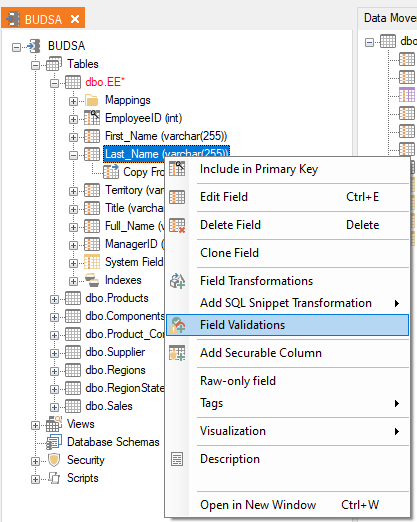

  1. Right-click the field and select Field Validations.

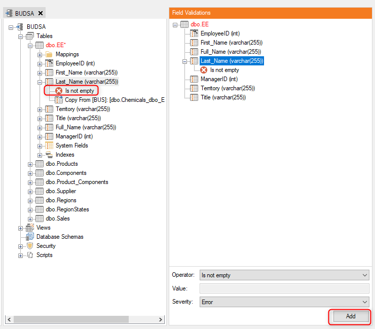

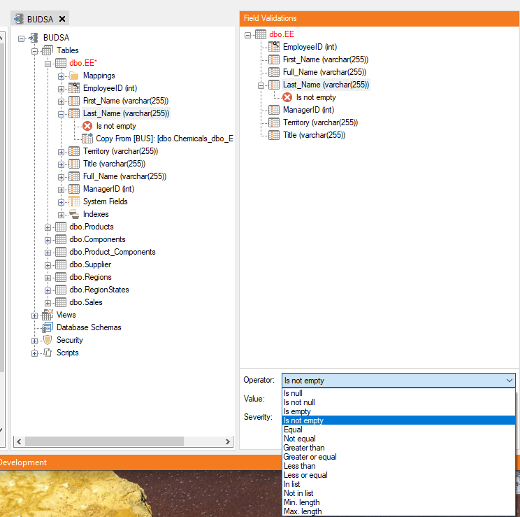

  2. In the right-hand pane, select the appropriate operator from the list at the bottom. In this case, we are choosing “Is not empty”, but “Is not null” may also be required depending on your circumstances.
Click the Add button to add the field validation, which will then be listed out beneath the field in the table.
Any record that is missing a value in that field will now be excluded.

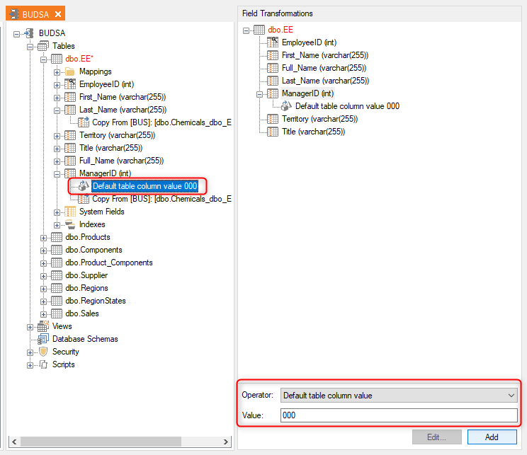

Default values
TimeXtender has a Default transformation.  This will put a value you specify into any record that has no value for that field using a DEFAULT constraint.  An example is shown here:

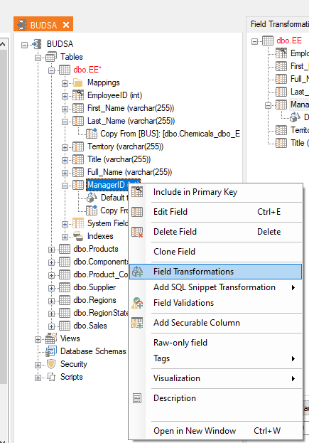

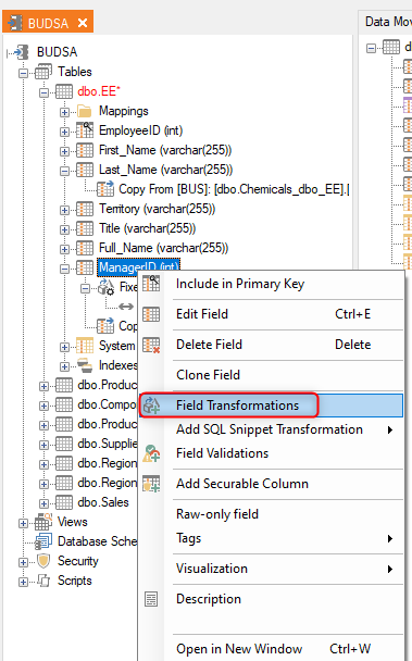

  1. Right-click on a field and select Field Transformations.
  2. In the Operator drop-down, select “Default table column value”.

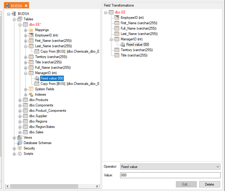

  3. Enter a default value that will act as a placeholder.
  4. Click the Add button to add the field transformation, which will then be listed out beneath the field in the table.

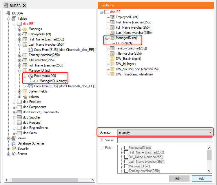

Fixed transformation when empty
A more robust solution is to set the field to a value when the field is empty.  This technique may have advantages over the default value technique described above.
One advantage is that some source systems use NULL for missing text values, while others (notably AX) use an empty string as a placeholder.  The "Empty" condition will allow this substitution to work in both cases, while an empty string will defeat a Default transformation. Use the following steps to add a Fixed Value transformation to a field that includes a condition of “Is empty” for when it applies.
  1. Right-click the field and select Field Transformations.
  2. In the right-hand pane, select “Fixed Value” for the operator.
  3. In the Value box, enter the value that will act as your placeholder.
  4. Click Add to save the Field Transformation, which will be shown beneath the field in the table.

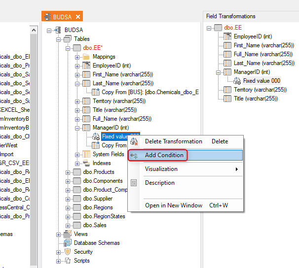

  5. Right-click on the Fixed Value transformation and select “Add Condition”.
  6. In the right-hand pane, select your field in the table above.
  7. In the Operator box below, select “Is empty.”
  8. Click the Add button to add the “Is empty” condition to the Fixed Value transformation.
