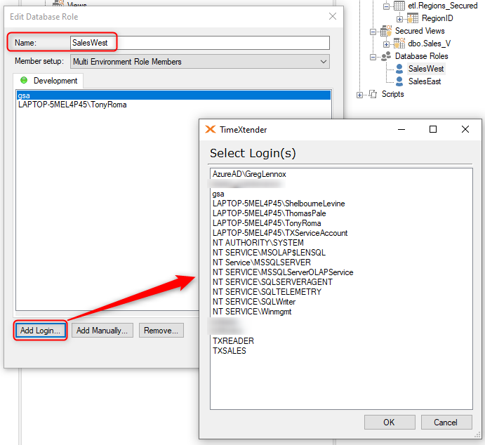

  1. Add a Database role:
  1. New Window Database role setup Click on Add login to role and select login and click ‘OK’.

Right-click Database Roles and Select Database Roles. Follow the above steps to create additional roles as appropriate. In our example, we are creating two roles, “SalesWest” and “SalesEast”, each with their own set of SQL Server logins as shown below:

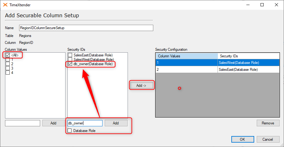

Defining Securable Column on the Dimension Table:

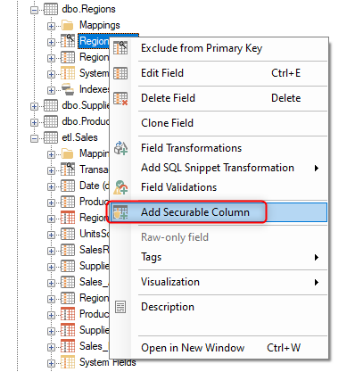

In my data warehouse, the dimension table I want to use to filter my data is the dbo.Regions table.
  1. Right-click on the primary key field in this table (RegionID) and select Add Securable Column.
  1. Click on Add Securable Column and then click OK after confirming the Dimension table and its primary key are selected for the Table and Column.
  1. The Add Securable Column Setup screen will then open automatically, where you can add as many setups as is needed to complete the secuable column. Do the following to add a setup:
  • Check a box or boxes under Column Values.
  • Check a box under the Security IDs that will correspond to the column values. If the Security ID needed, is not present, use the Add button beneath to add it on.
  • Click the “Add->” button in the middle of the dialog to add the Security Configuration to the box on the right..
The Column values are the primary keys in your dimension table. In this example, the key value of “1” corresponds to “West” and “2” corresponds to East. The Security IDs correspond to the Database Roles on the SQL Server. In this example, the “SalesWest” roles has already been setup as equal to the Secure Column value of 1. To setup the SalesEast database role, check the box for the number “2” in the Column Values, then check the “SalesEast” database role under Security IDs and click the “Add” button.
  1. After setting up all the database roles that will be used to filter the fact table, add the db_owner to the list of Security IDs by unchecking the “Database Role” box and typing in “db_owner” and clicking the Add button.
    In the Column Values, check the <All> box and then check the db_owner Database Role and click the Add button to add this to the Security Configuration. You can also do the same for BIDevelopers Active Directory Group to ensure that developers have access to the unfiltered fact table.
  1. The complete security setup appears as follows:
The above will filter the secured view so that West Sales people only see sales in the West Region and East Sales people will only see sales in the East Region, but developers will see all of the sales. Notice that the BIDevelopers group is added as a System User, so Security IDs are not limited to database roles as created in TimeXtender, they can be SQL Server Logins that are created or maintained in the SQL Server Management Studio.

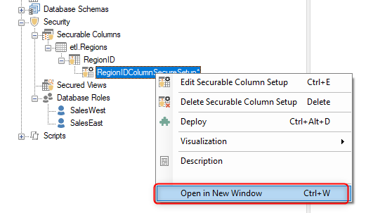

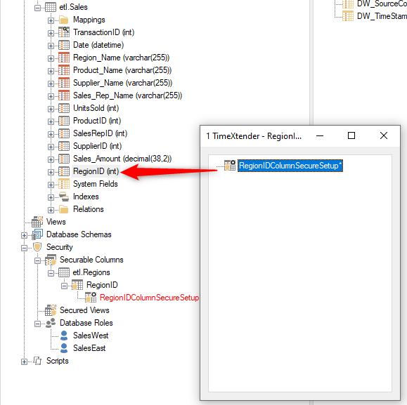

  1. Open the Securable Column Setup in a New Window.

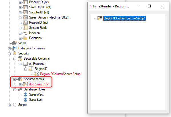

  1. Select column RegionID under Sales fact table, which is the relevant foreign key in the fact table. Drag the RegionIDColumnSecureSetup onto the RegionID field.
    The dbo.Sales_SV view is created under Secured Views.

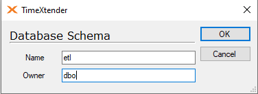

  1. Right Click the Database Schema and Select Add Database Schema.
  1. Name the Database Schema as etl and click OK.
