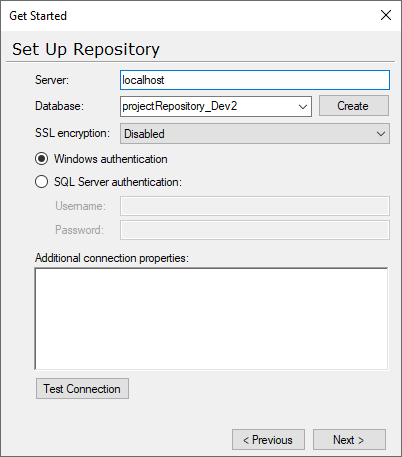

Create a Repository Database for each Environment
You must create a new project repository database for each Environment. It can be helpful to follow a naming convention to clearly identify each database such as projectRepository_Dev | projectRepository_Test | projectRepository_Prod. These databases should reside on the associated environment server. To create another repository database:
  1. In TimeXtender Classic Tools Menu > Options > Project repository Tab
  2. Indicate the correct server name.
  1. Type the desired database name for this new repository.
  2. Click Create.

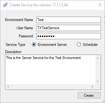

Configure the Server Service for each Environment
Each environment (except for Development) needs to have a TimeXtender Classic Server Service. You'll need to modify the service to use the "Log-on As" service created in the previous step. (Please note: you will be unable to start the service until you 1. Assign the service user to the associated environment's project repository[step below] and create the associated environment(s) in TimeXtender Classic. [step covered in the first video below])
A TimeXtender Classic Scheduler Service and a TimeXtender Classic Server service are installed when installing TimeXtender, so you may not need to create a new service. However, if you are running two (non-dev) environments on the same machine, you will need to create another Server service. To create an additional service:
  1. TimeXtender Classic Tools Menu > Windows Service Setup
  2. Options > Create Service
  3. Provide the necessary info for the service & click create. (You may need to complete the following step first.)

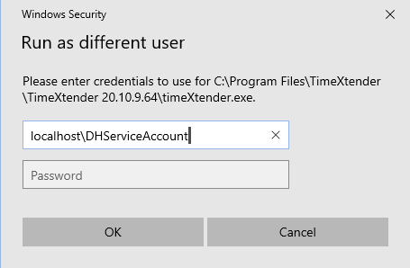

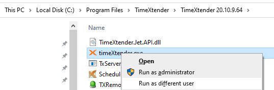

When you start the Server Service, the "Log-on As" user opens an instance of the TimeXtender.exe process (TimeXtender Classic without the UI) in the background. This process needs to know what repository to connect to. To assign the Service Account to the associated environment's project repository:
  1. Log into windows using the service account that will be used to run the service and launch TimeXtender Classic...   OR
  2. Navigate to the timextender.exe application file in the TimeXtender Classic installation directory, Shift+Right-Click and choose Run as different user.
  3. Enter the credentials for the Service Account and click OK. This will run the TimeXtender Classic application as the Service Account user.
  4. TimeXtender Classic will ask you to enter the SQL Server and Database name for the project repository. Enter the server and database for the repository you want to associate with the service. Click OK/Next to confirm your settings.
  5. Close TimeXtender Classic

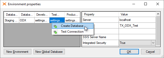

  5. Create new databases as necessary by right-clicking on "settings" in the desired cell.

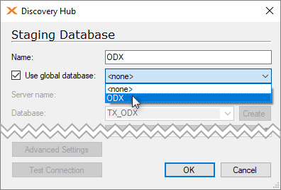

  7. Right click on the desired database in your project and click Edit Database
    • Click: Use Global Database
    • Select the created global database from the drop-down.

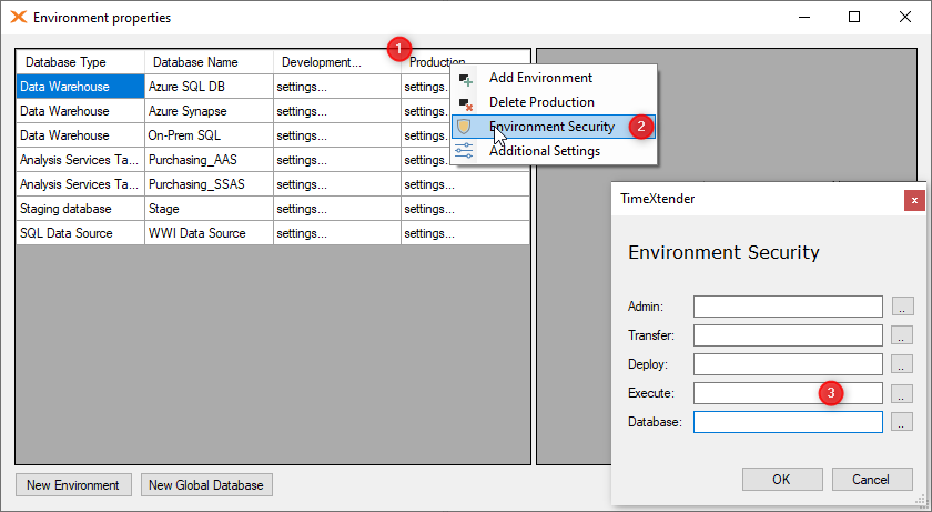

Multiple Environment Security
Once Multiple Environments are configured, you can assign which security groups have permissions to perform certain actions.
Open Environment Properties
  1. Right-Click on the Environment name you wish to secure.
  2. Click Environment Properties
  3. Assign the Active Directory group which you wish to have this permission.
  • Admin: Can carry out all below actions. (Specifying a security group for the Admin role ONLY, will disable any of the following actions in the specified environment for users not in that group.)
  • Transfer: Can transfer projects to this destination environment through the Environment Transfer Dialogue.
  • Deploy: Can Deploy this destination environment through the Environment Transfer Dialogue.
  • Execute: Can Execute this destination environment through the Environment Transfer Dialogue.
  • Database: Can edit properties and perform the create databases action in this environment within the Environment Properties Dialogue. Users not granted the Database permission will be able to view all properties but will not be able to modify them.
