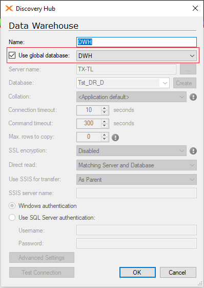

  2. If you use multiple environments, these settings won’t be saved, so a good idea would be to set all the global databases back to the project settings before you export them. Uncheck the Use global database field and press OK.

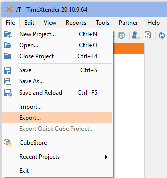

  3. Then click on File and then Export.

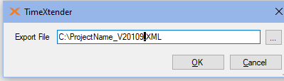

  4. Save it somewhere that is available from other user accounts. The name should be something like ProjectName_V20109.XML. It is important to add the version as it only works for this version of TimeXtender Classic.

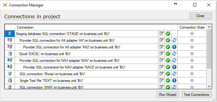

  4. When prompted, run the connection manager
  5. Run the wizard and remember to create all the databases, as they are not present on the new server.
