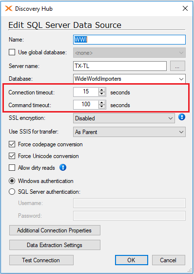

  1. Data source timeouts. Such as SQL. The standard settings is the same in all adapters except excel, text and to some degree Any Source. In Any source connectors there might be a field you can change that contains timeout settings. The defaults are Connection 15 and Command 100. The reason it is waiting 100 and not higher, is because it only does the transfer from one server to the other and isn't doing any of the data cleansing.

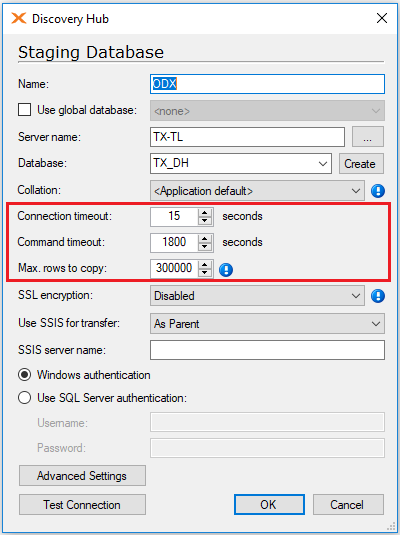

  2. In the DSA Staging database. Here the default for Command timeout is 1800 seconds, as a lot of data cleansing will be done in here.

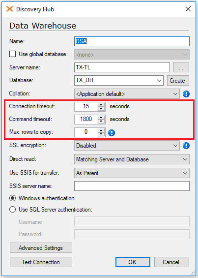

  3. In the Data Warehouse databases. It is similar to the Staging database in its standard settings.

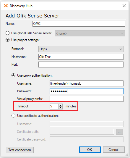

  4. Command timeout in Qlik Sense Server

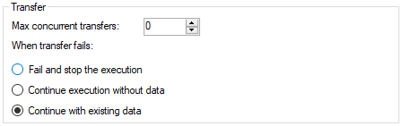

    • Choose what happens when it fails.

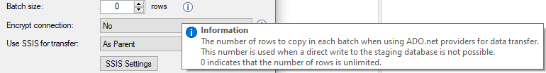

    • Some of the data source adapters have a batch size option. Decrease it, so you split out the execution in more parts.
    • Some are set to 0 by default, so setting it to a number will reset the timeouts after each batch has been transferred.
