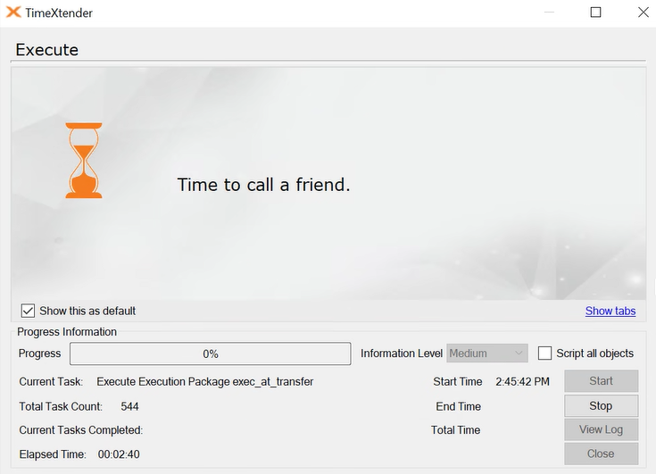

After deploying to production, we ran a package manually and noticed it not proceed past the above step. The “current tasks completed” stayed at 0, and no data was being loaded, even after waiting up to 30 minutes. We tried running it multiple times, but nothing changed. Running individual tables worked fine.
We checked the SQL database usage for the DSA to be sure, and it wasn't being affected—no data was loading as expected.

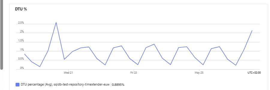

We increased the repository to 200 DTU but it still got stuck and reached 100% usage. Interestingly, our test environment is an exact copy of production. It uses the same repository setup (yet only 100 dtu) and scheduled loads, but the same query runs there with much lower IO usage.
This is the test repository looking over 7 days.

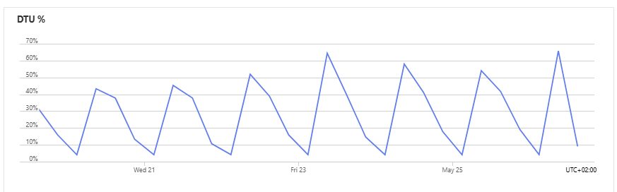

This is prod
Like I said, these environments are 1 to 1 and running exactly the same amount of loads every day. I can’t find any explanation for this.
Anytime we start a package the repository instantly goes to 100% in prod and drops to 0% when we stop the package.

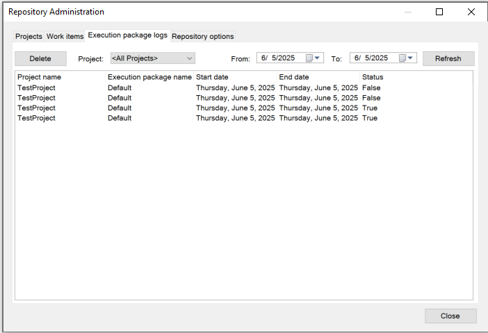

@Victor also please consider cleaning up execution logs (go to Tools, Repository Administration, and delete old execution package logs) as well as contacting a dba to review SQL db settings and logs

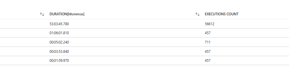

I can find no deadlocks on the DB in any logs or metrics. The query store has a lot of entries, but the above query is the biggest one by light years, and nothing else comes close.
Below is a summary of top data io querys over the past 7 days. The query I linked is the top one here.

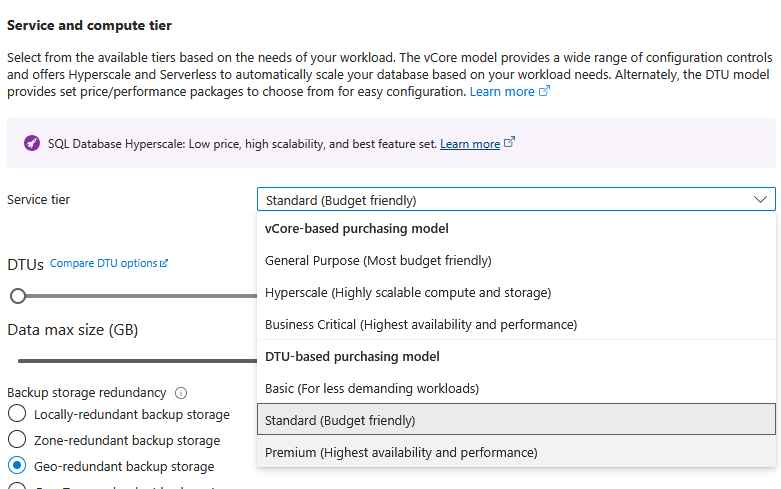

​Hi @Victor which service tier are you using?
We have seen in the past that increasing DTU does not necessarily resolve these types of issues, if the IO is being overloaded increasing the service tier of the database typically resolves this issue. Can you please try to set service tier to premium?
