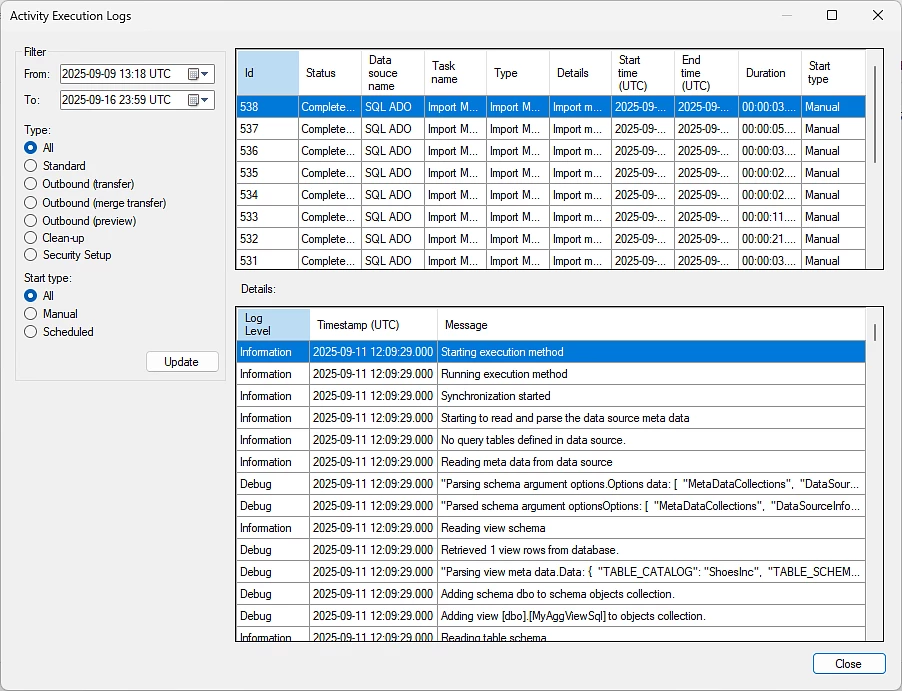

The Ingest instance services logs all execution attempts to log files in the local file system in the W3C Extended Log File Format. The Execution Log reads these files to show you all the previous task executions. You can open the log on the instance level or scoped to a specific task.
To view executions for the entire instance
  • Right-click the ingest instance and click View Execution Log.
To view executions for a specific task
  •  Right-click the task and click View Execution Log.
In the Execution Log window, the top list shows the task, while the bottom list shows the details for a selected tasks.
In the left-hand side of the window, filter options are available:
  • Time span (From and To dates and time)
  • Type of task:
    • All: All the rows in the given timespan
    • Standard: All transfer execution tasks
    • Outbound (transfer): Tasks transferring from Ingest → Prepare.
    • Outbound (merge transfer): Tasks using the ADF merge threads option for transferring from Ingest→ Prepare.
    • Outbound (preview): When someone is previewing a table.
    • Clean-Up: Clean up tasks.
    • Security Setup: The tasks that adds security to a data source.
  • Start type:
    • All: Is all the tasks
    • Manual: Manually started tasks.
    • Scheduled: Scheduled tasks.

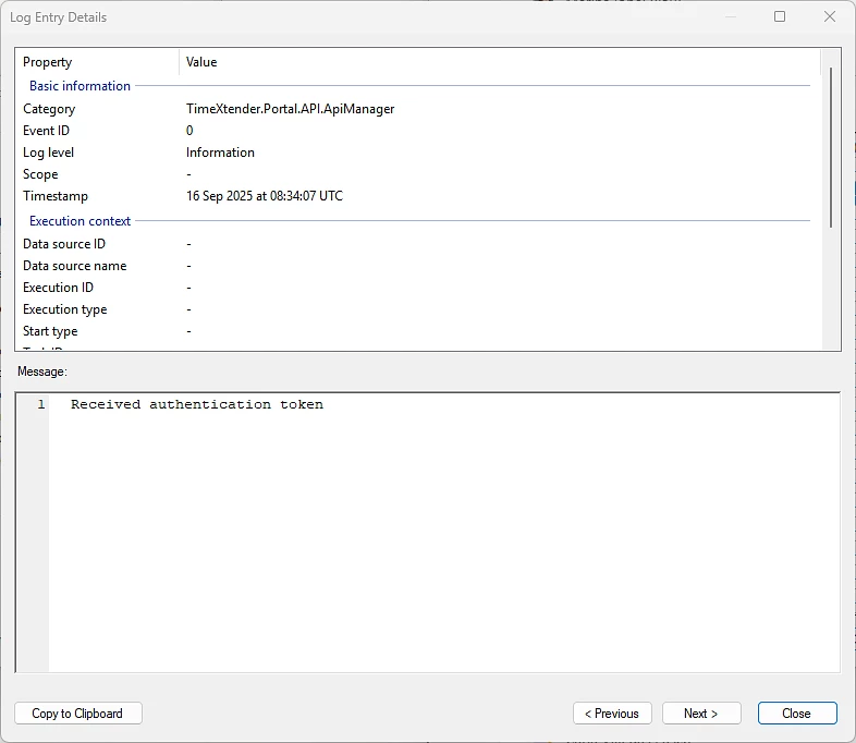

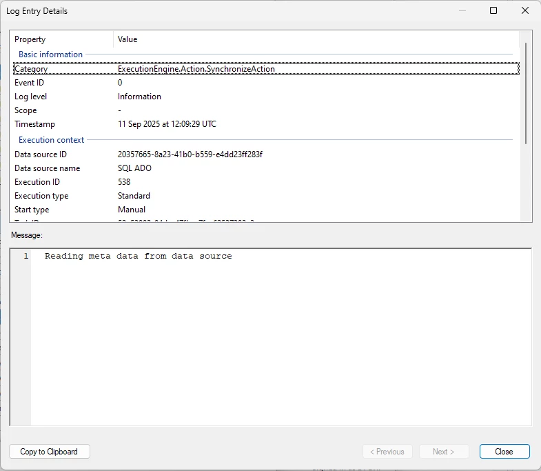

In the Detail list, the messages are often too long for the column. To open the Log Entry Details window to see the full message. double-click the item in the Details list.
In the Log Entry Details window, the properties of the message is displayed in the top table followed by the message itself.
To move the the next or previous message within the same task execution, click < Previous or Next >. Click Copy to Clipboard to copy the message to the clipboard for sharing.

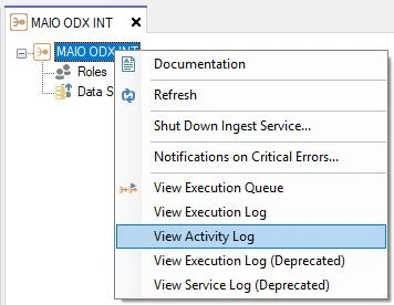

To open the Activity Log
  • Right-click on the Ingest instance and select View Activity Log.

In the list, the messages are often too long for the column. To open the Log Entry Details window to see the full message, double-click the item in the list.
To move the the next or previous message within the same log entry, click < Previous or Next >. Click Copy to Clipboard to copy the message to the clipboard for sharing.
