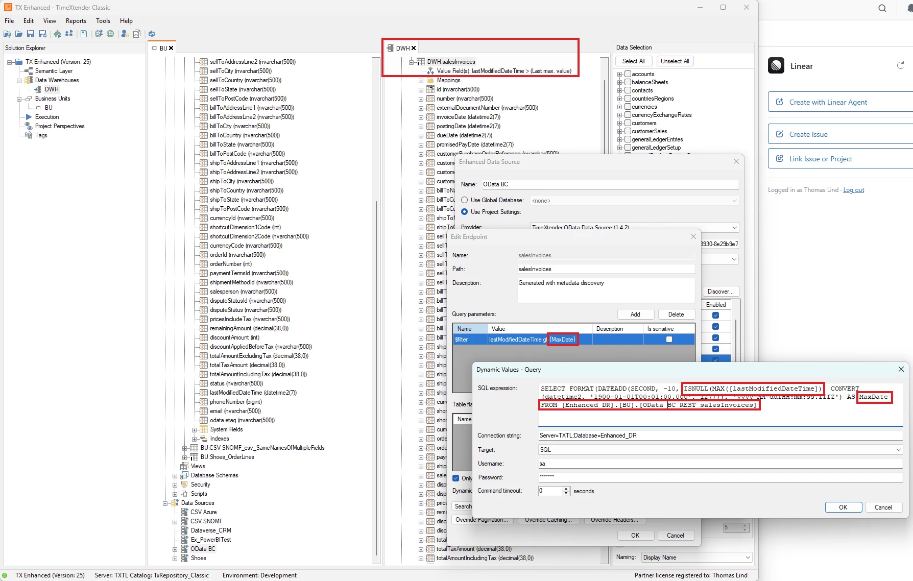

Best answer by Thomas Lind
Hi ​@aftabp
I will share my suggestion here as well for others to see.
The Enhanced Rest provider does not support Incremental load at this point. So while you can turn it on, it will fail with the error you see. You can use incremental load on REST data sources in TDI, so it may be added eventually.
You can still do something so it behaves like it is using Incremental load.
I set the DWH version of a table to run with incremental load without deletes and use a field from the source table to check. Normally you use the DW_TimeStamp, but for this I chose a specific datetime field of the source table.
I use a dynamic SQL query to pull a MaxDate from the table that I then use as a Query Parameter. The source is a Microsoft API, and it always supports $filter with a value like fieledname gt (greater than) datetime.
SELECT FORMAT(DATEADD(SECOND, -10, ISNULL(MAX([lastModifiedDateTime]), CONVERT(datetime2, '1900-01-01T00:01:00.000', 127))), 'yyyy-MM-ddTHH:mm:ss.fffZ') AS MaxDate FROM [Enhanced_DR].[BU].[OData BC_REST_salesInvoices]
I also connect to the staging database that contains the table. The important part of the SQL query is that it needs to support a date that will be used on the first execution. I found that this only allowed a 30-day filter. So the 1900-01-01 isn't actually valid, so if I needed to run a full load or similar, I would need to add a date that isn't older than the current day - 30.
The downsides with this method, compared to actual incremental load, are that the SQL needs to be added to all endpoints and that you have to set it up for the DWH level. Once the real incremental feature is added, it will be easy to change as the method currently used in TDI is very similar to this.

Hi ​@aftabp
