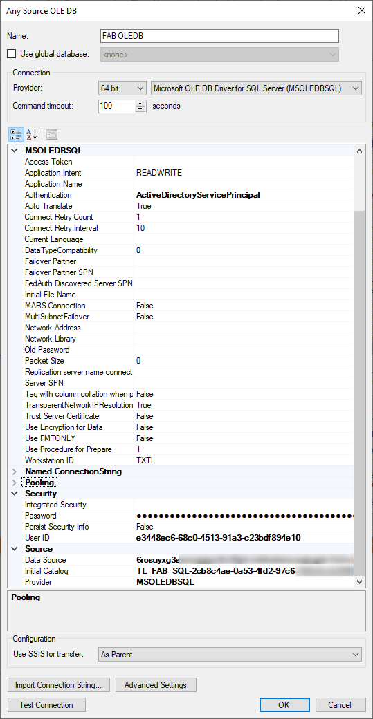

  • May 14, 2025
Thank you, this was exactly what i was looking for.
I’ve considered the OLEDB provider, but the field Authentication did not have a dropdown.
Now ive put in the string ‘ActiveDirectoryServicePrincipal’, i can easily connect to synapse or fabric sql endpoint using SPN.
Now I have some new options; thanks!

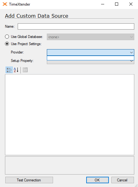

One more question though, now i am reading up on the subject:
Provider options to connect TimeXtender to a SQL Server Data Source – TimeXtender Support
The link provided states the SQLOLEDB provider is old.
And I should use the ‘CDS (Custom Data Source) provider for SQL’
But cant find any documentation how to setup this CDS?
Should i just continue using OLEDB?
