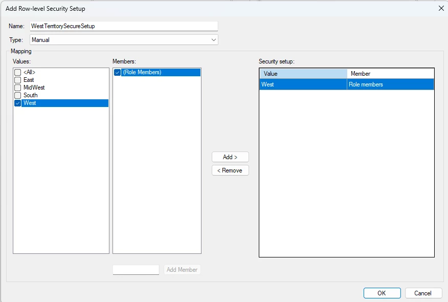

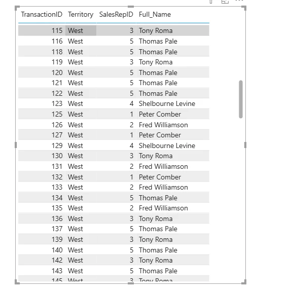

A Row-Level Security Setup is created under a specific field and specifies which field values that a role or a specified user will have access to, which means that that role or user will also not have access to any data that is not related to the field values that are specified as part of the Row-Level Security Setup. In this way, Row-Level Security Setups associated to Roles work together to implement the security access to the endpoint based on the identity of either the Role members or specified user logons that may be accessing the endpoint through a presentation application like Power BI.
As an example, the “TerritoryWest” Security Setup shown below has been created based on the “Territory” field and is granting access to the subset of data that is related to the “West” Territory field value.  Any role associated with this security setup will only have access to the “West” associated data and not have any access to data that is not associated with the “West” territory.
This can be confirmed by connecting to the endpoint in Power BI as one of the Role Members associated with the Security Setup above and verifying that only “West” Territory entries are displayed in the Sales table.

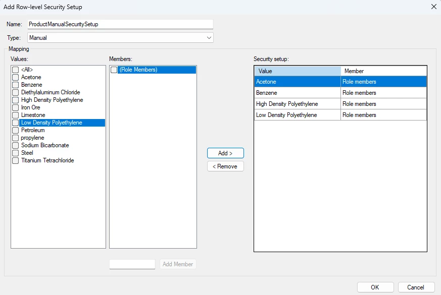

Manual Row-Level-Security Example using Multiple Roles and Multiple Security Setups
The following steps outline how to configure a Manual Row-Level Security Setup.
  1. Right-click on a Semantic model field and select Add Row-level Security Setup to open the following window.
  2. In the Name box, enter a name for the setup.
  3. In the Type menu, keep the default setting of “Manual.”
  4. Complete the following steps to add one or more security setups:
    1. From the Values list, select one or more of the available field values.
    2. From the Members list, check the (Role Members) box to apply the setup to the members of the Role(s) that the setup will later be associated with.
    3. (Optional) Additional members can be added to the Members list using the Add Member box at the bottom, which provides a way to configure access for specific users. Enter a username in the text box and click the Add Member button to add a user to the Members list. Usernames may need to be Full Qualified in order to resolve properly, i.e. specified in the following format: <DomainName\UserName>.
  5. Click the Add >” button to map the selected values to the selected members.
  6. Note: Users added as Additional Members may not work with all Endpoints. AD Groups may also not work as Additional Members. Verify that access is working properly for all Additional Members added to Row-Level Security Setups that are associated with Roles that are associated with Endpoints.
Note: If you want to select (Role Members) to be associated with the selected values, then it may be necessary to have multiple Roles and Security Setups, and for each Security Setup to only be associated with its own particular Role. The following is an example of this where there are 5 different Roles (West, East, All, MidWest, South) and each Role has its own Security Setup, i.e. the West Role is associated to the WestTerritorySecureSetup, and the East Role is associated with the EastTerritorySecureSetup, and so on. The benefit of this approach is that you can use AD Groups for the Role Members and as such the Roles and the Security Setups do not need to be amended or updated when Role members change, i.e. people join or leave the organization.

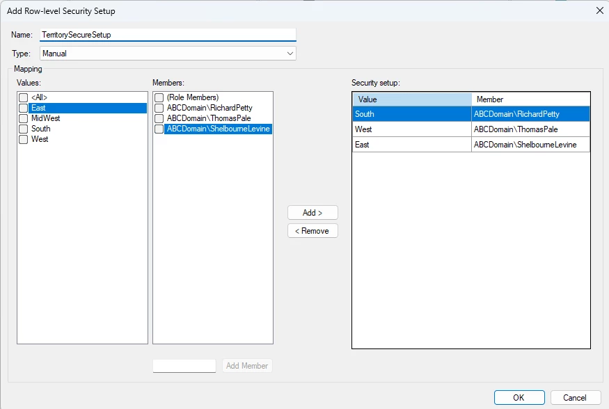

Manual Security Setup using Additional Members
If you do not want to use (Role Members) that may entail multiple security setups, it is possible to Add Members individually using the “Add Member” button down below. In that way, you can directly tie the members specified to just those values you want them to see, and you can specify different values for different members in the same Security Setup, similar to the following.
Note: By using Additional Members and specifying domain usernames explicitly, different users can be mapped to different field values in the same Security Setup. This type of setup simplifies the amount of objects needed to deploy the entire Security infrastructure, but it may also create an on-going maintenence issue as the Security Setup will need to be amended when users need to be added or removed from the setup.

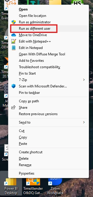

It is recommended to open the Semantic endpoint in a presentation application like Power BI before creating the Security Setup and create a table that can be used to verify that the Security Setup is working as expected once it is configured, deployed, and executed. If you have the desktop install of Power BI, you can shift+right-click on the Power BI Desktop icon to open the context menu where you can run the application as a different user.
The approach will allow you to open the Semantic endpoint as different users and confirm that each user only has access to that portion of the data model that is associated with their own name or domain logon.

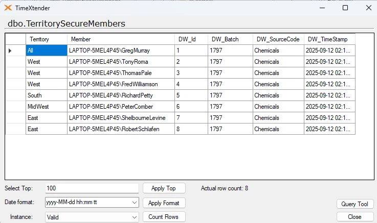

Dynamic Domain Logon to Territory Field Values Secure Setup Example
The Manual Secure Setup Example above required us to create 5 Roles and 5 Secure Setups. We can accomplish the same thing using a Dynamic Secure Setup that only has 1 Role and 1 Secure Setup, however, this Secure Setup will need to use a table that delineates all of the users and which Territory value they below to. In this example, the Secure Setup data warehouse table appears as follows:
Once this table is available in the data warehouse, the Security Setup that uses that table can be created as follows:
Afterwards, the Secure Setup needs to be associated to a Role that contains all the members as listed out in the table, and that Role needs to be associated with the endpoint. The complete setup is shown in the following GIF.

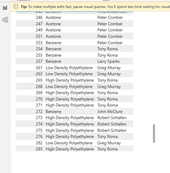

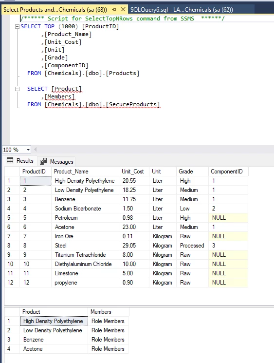

Dynamic Product Security Example using Role Members
Another common security setup will involve a table that has a large number of entries and you want to restrict what is shown in the model to a subset of those values for a specified group of users, and there is also another group that has access to all of the field values. This can be done using either a Manual or Dynamic Security setup.
Dynamic Security Setup
The first step would be to create an AD Group that has all of your users in it, similar to the “SalesReps” group that has been used in the examples above.
The second step would be to create a table that can be used for the Dynamic Security Setup. The table will have one column for the values that you want to include in the model and the other column is a “Members” column with the value of “Role Members” for all of the rows. In the following example, a “SecureProducts” table has been created that contains a subset of all values in the “Products" table as described above.
The endpoint will then restrict the data shown for the SalesReps so that they only see Sales data related to the 4 products in the “SecureProducts” table.
The Dynamic Security Setup will be created under the Product_Name field and look like the following:
The following screenshot shows what the SalesReps will see when the open the endpoint and how the results only include the 4 products as configured by the Security Setup.

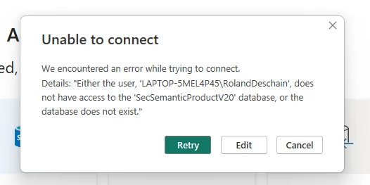

If someone who is not part of a Role that has been associated to the endpoint tries to open the endpoint, then they will receive an error message similar to the following:
Note: the only exception to the “Unable to Connect” error message above would be if the user opening the endpoint is an Administrator to the Analysis Services instance, then that would override the security setup in the Semantic model and they would have full access to all the data in the model.
