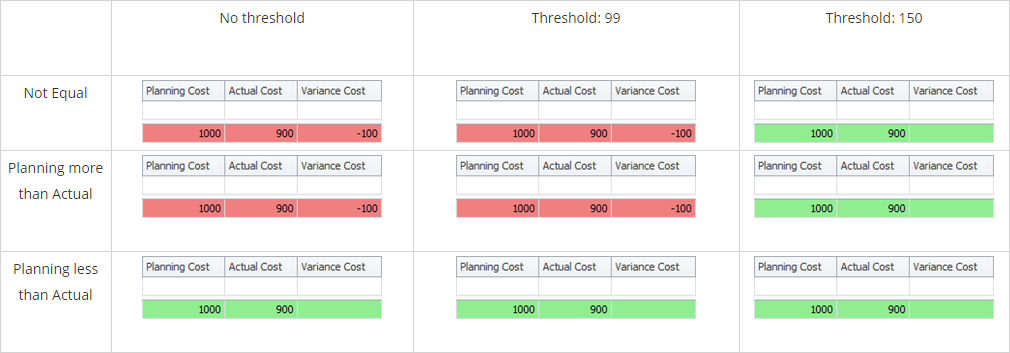

To visualize these differences let's compare two data sources, Planning and Actual against each other with different options. Both will contain the column Cost, with Planning’s column having the value 1000 and Actual having 900.
The results can be summarized as such:
  • Not Equal and Planning more than Actual both always create errors unless the threshold is more than the difference between the values.
  • Planning less than Actual never creates an error, irrelevant of threshold values.
  • When the threshold is more than the difference of values, an error is never created.
