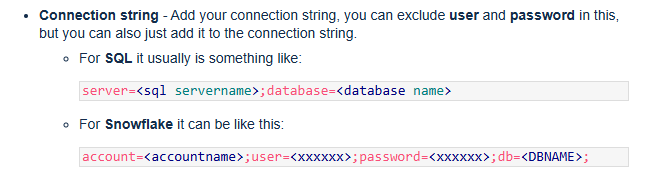

  • Connection string: You will need a SQL or Snowflake server to perform the above calculation and make pagination work. It should be in the following format:

Please note that the way you fill in the connection string for the pagination SQL query needs to be in this format:
I was trying to set this up by simply filling in the server name, but got some vague errors. You can find more information about this setting on this page:

Thanks ​@KajEmergo,
I updated the guide to reflect this.
