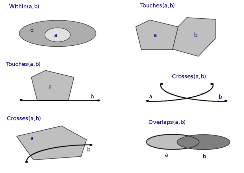

Basically it's about geometry/spatial relations, operations like e.g. Is point P on the line L? Or How far is the distance between two points P1, P2? - think 8th grade math.
Examples for spatial relations (https://en.wikipedia.org/wiki/Spatial_relation)

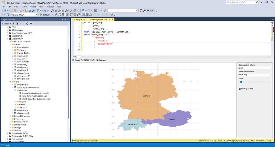

You can even plot the shapes in SQL Management Studio, which can be very helpful:

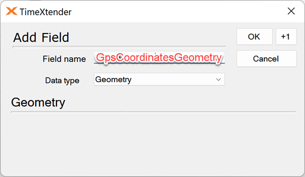

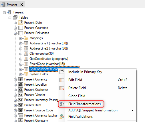

Create a new field in Deliveries called GpsCoordinatesGeometry and make sure the field type is Geometry.

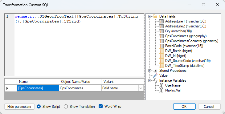

Create a Field Transformation on the field of type Custom value and insert this custom SQL:
geometry::STGeomFromText([GpsCoordinates].ToString(),[GpsCoordinates].STSrid)
Make sure the parameter is mapped:

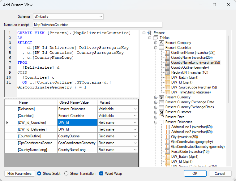

Create a custom view with the actual spatial join
Next, create a Custom View with this code:
CREATE VIEW [Present].[MapDeliveriesCountries]
AS
SELECT
    d.[DW_Id_Deliveries] DeliverySurrogateKey
  , c.[DW_Id_Countries] CountrySurrogateKey
  , c.[CountryNameLong]
FROM
  [Delivieries] d
JOIN
  [Countries] c
  ON c.[CountryOutline].STContains(d.[GpsCoordinatesGeometry]) = 1
Again, make sure, all parameters are mapped:

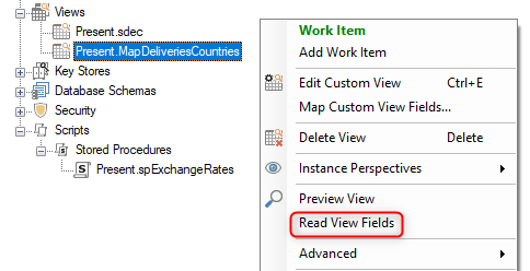

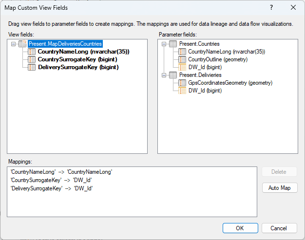

After deployment, right click the new view and select Read View Fields:
And then mapping the view, by setting the relations in the Map Custom View Fields menu.
You can’t auto map the whole thing, so map CountrySurrogateKey to the DW_Id of Countries and DeliverySurrogateKey to the DW_Id of the Deliveries.

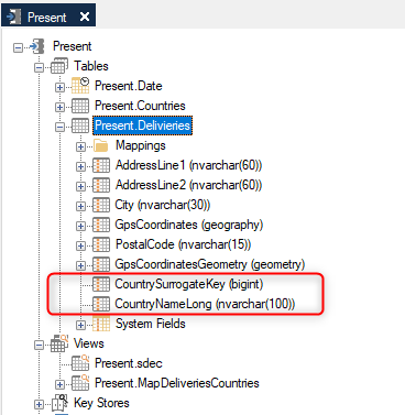

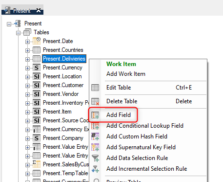

Prepare Deliveries table with additional columns
Next, create two fields in the Deliveries table to hold the CountryNameLong and the CountrySurrogateKey, the Foreign Key to the Countries table for the relationship:
Create the following fields:
  1. Name: CountrySurrogateKey, type: bigint
  2. Name: CountryNameLong, type: nvarchar, length 100

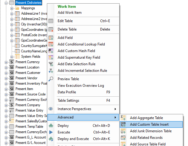

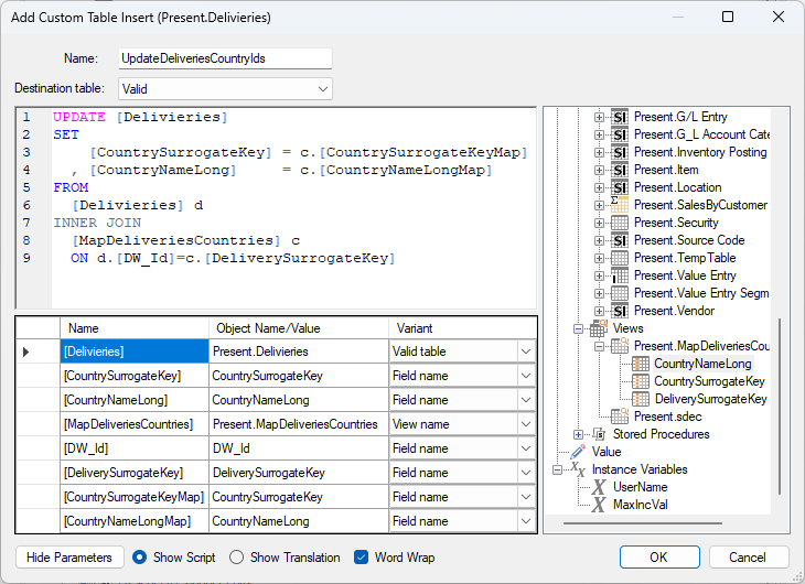

Next we need a Custom Step Script Action
Name it UpdateDeliveriesCountryIds and insert this Custom SQL:
UPDATE [Delivieries]
SET
    [CountrySurrogateKey] = c.[CountrySurrogateKeyMap]
  , [CountryNameLong]     = c.[CountryNameLongMap]
FROM
  [Delivieries] d
INNER JOIN
  [MapDeliveriesCountries] c
  ON d.[DW_Id]=c.[DeliverySurrogateKey]
Again, make sure that all parameters are mapped:

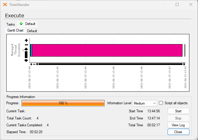

Now it’s time to deploy and execute.
Note how the update takes pretty long for the small amount of data in the execution – spatial joins are computationally expensive operations!

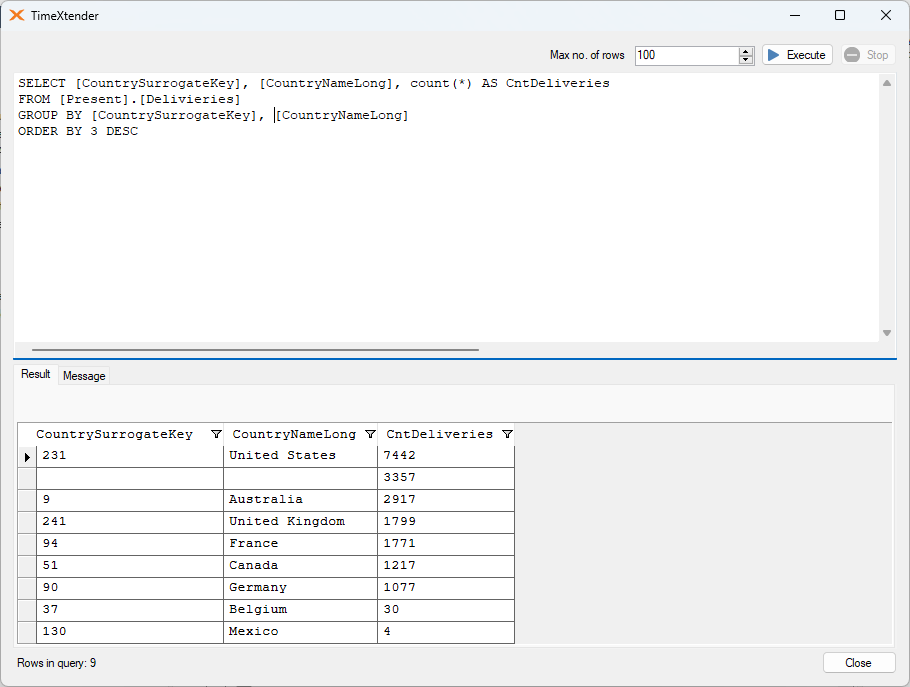

Now we can use the Query Tool to see the results, e.g. by executing a query like this:
SELECT
  [CountrySurrogateKey],
  [CountryNameLong],
  count(*) AS CntDeliveries
FROM [Present].[Delivieries]
GROUP BY [CountrySurrogateKey],
  [CountryNameLong]
ORDER BY 3 DESC
It shows most Deliveries happened in the US, but also that 3,357 deliveries couldn’t be mapped to a country in this example.
