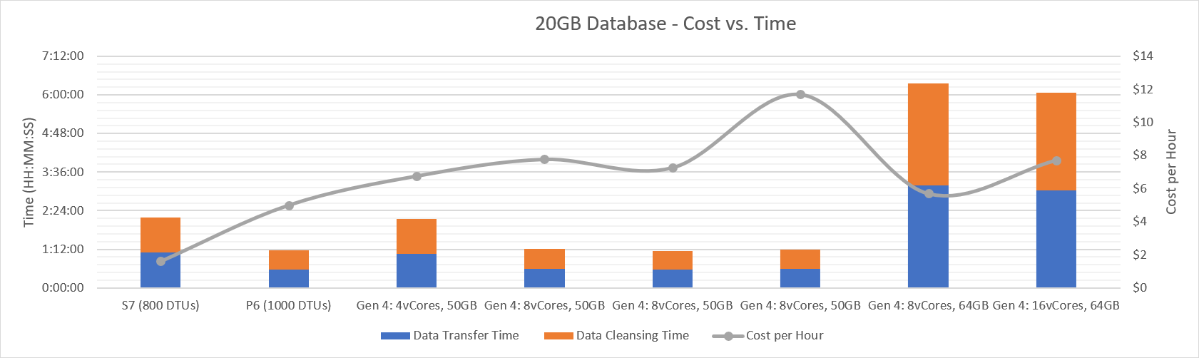

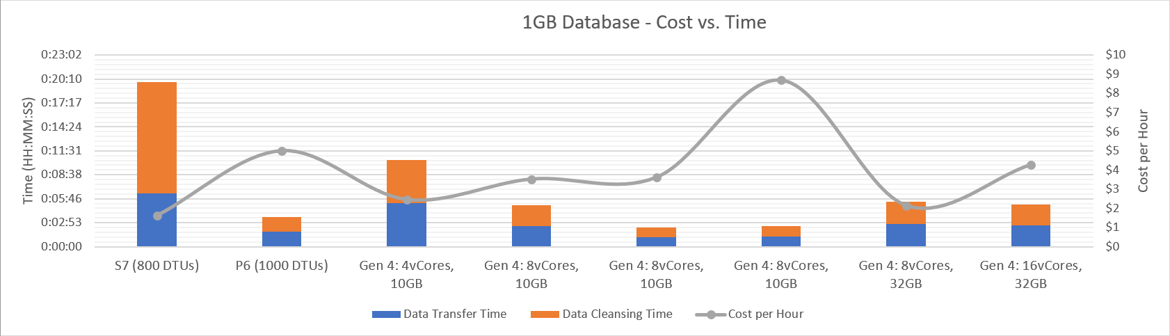

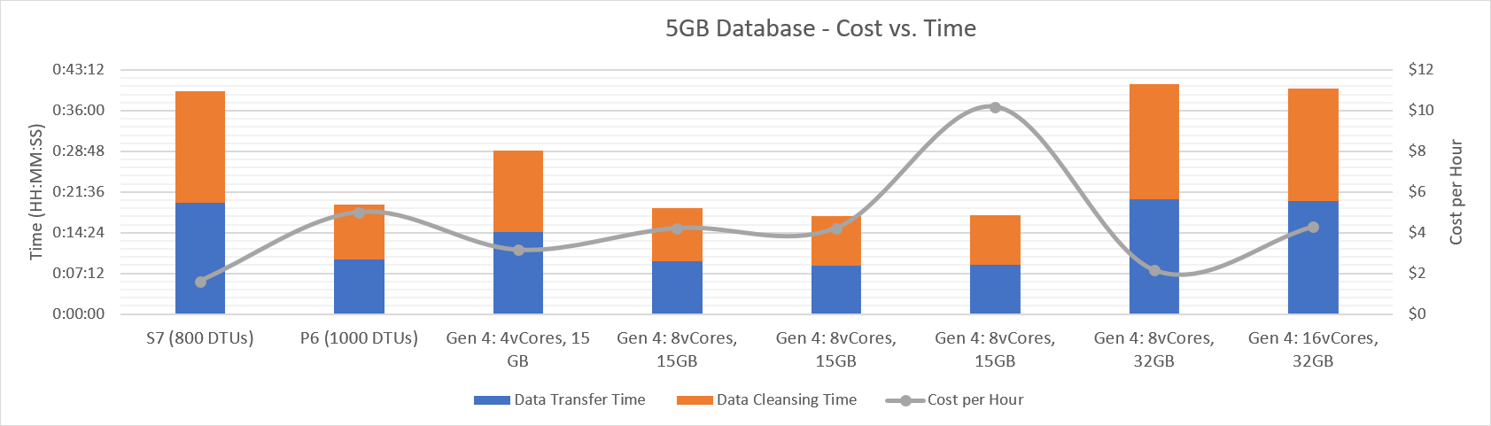

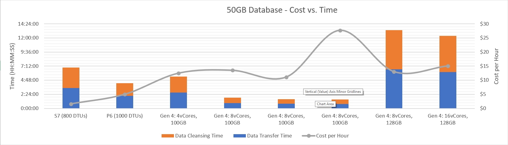

Performance Testing
Testing Methodology
  • Full load of the entire sample database in data warehouse
  • Tested across 5 different sized databases (1GB, 5GB, 10GB, 20GB, 50GB)
  • Data is transferred from one Azure SQL Database (DSA) to another Azure SQL Database (MDW) to reduce any network latency.
    • The Azure SQL Database used for the DSA remained the same across each test (Standard S0:10 DTUs)
  • Discovery Hub is hosted on a Virtual Machine in Azure
    • VM Size: DS2_v2 (2 VCPUS, 7 GB RAM)
  • MDW has a number of complex transformations and cleansing procedures that occur during execution
  • Max rows to copy = 300,000
    • This is the number of rows to copy when using ADO.NET providers for data transfer
Sample Database
The structure of the sample database that was used for testing is the same across each test.
  • 95 tables
  • 6 different schemas
  • 4 large tables (1 million+ records)
The structure of each of the different sized databases (1GB, 10GB, 20GB, 50GB) is the same. The only difference between them is the amount of data in each table.
Test Results
To view the detailed test results, download the Excel file at the end of this article.
Below are visual representations of the test results that plots the data transfer times and data cleansing times versus the hourly cost for each service tier and performance level that was tested.
Findings
