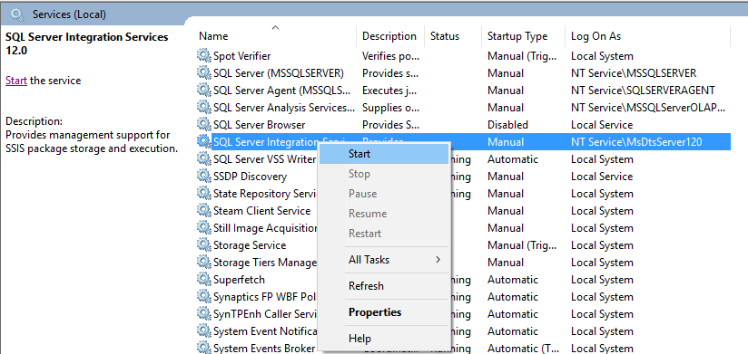

SSIS Verification
To verify the installation of SSIS, click on the Windows Start button, type “services.msc” (without the quotes), and hit enter.
The image below verifies the installation of SSIS.

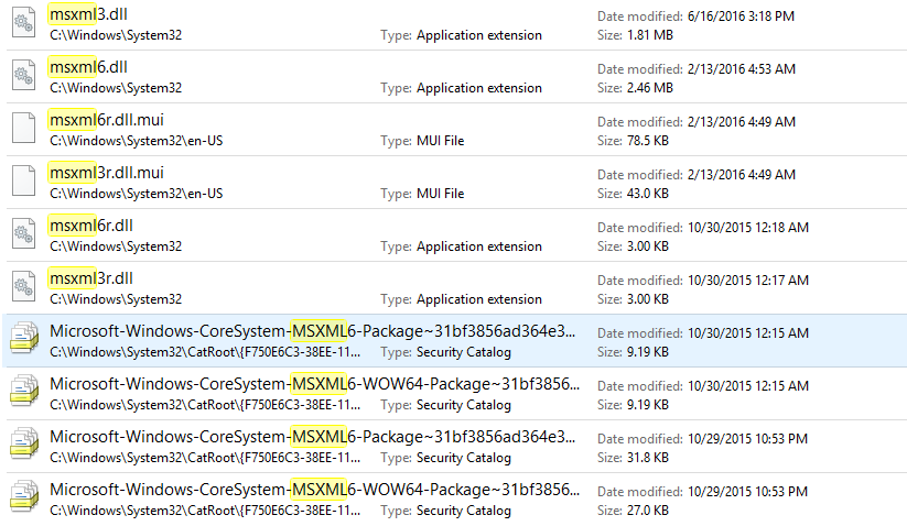

MSXML Version Verification
To verify the version of MSXML on the server, navigate to C:\Windows\System32 folder. In the search field, type in “MSXML*” (without the quotes). The results should look similar to the image below.

SSIS Error
Error: Error creating DTS package for…
- Issue: SSIS is either not installed or running.
- Resolution: Verify SSIS is installed and running. See SSIS Verification above to check.
- If SSIS is missing, it can be installed using the Microsoft SQL Server installation.
- If you encounter the following image then SSIS is not running. Click on Start in the upper left to start the service.
Alternatively, right-click SQL Server Integration Services and choose Start Service.
