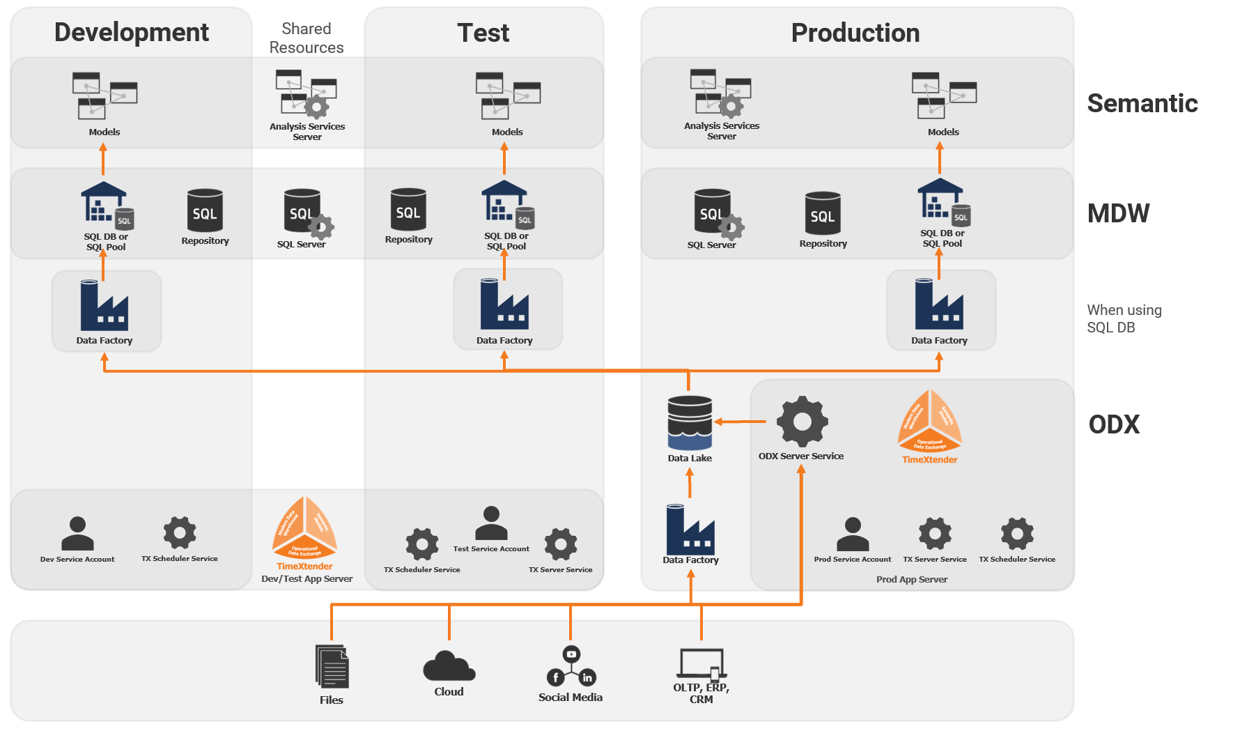

In order to implement multiple environments, you must first decide on your server configuration for your environments. The below image is an reference architecture of TimeXtender Classic configured with 3 Environments; Development, Test, and Production.
As you can see in the diagram, Development and Test are co-located on the same server. This can be done to save resource costs if desired. However, many organizations prefer to have the server specs of Test match the server specs of Production in order to analyze performance as well. Take the time to consider these and other factors before deciding on an architecture and, if necessary, consult your TimeXtender Partner to help make these decisions.
Some important aspects to note in the diagram:
  • Share Resources: Any/all environments may share some resources if desired to save cost/consolidate resources such as the Application Server, SQL Server, and Analysis Services Server.
  • Services: Dev only requires a scheduler service, Test requires both a scheduler service and a server service, and Prod requires the Scheduler, and Server service.

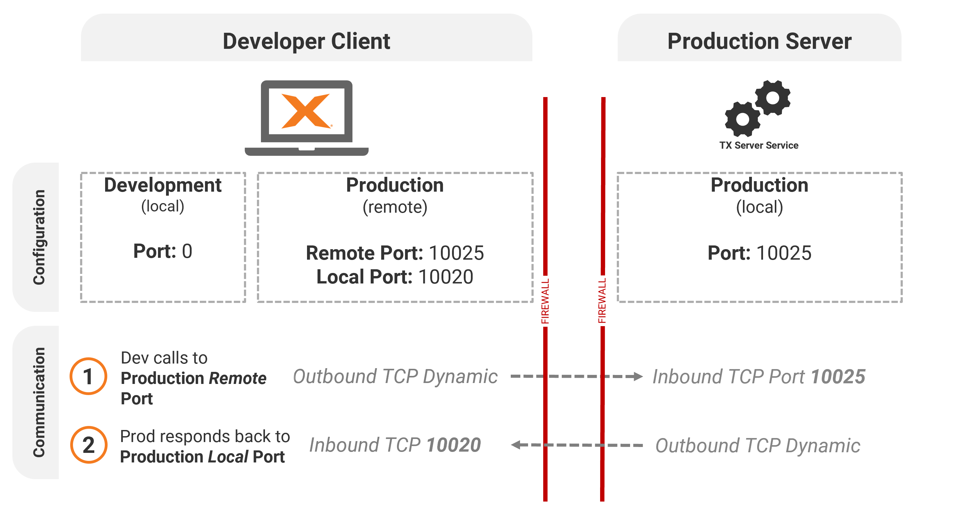

If configuring multiple environments across multiple servers it will be necessary to open the proper ports to allow TimeXtender Classic to communicate across the servers. This will depend on the ports you define for each environment. The below diagram is an example of a Development-Production configuration and subsequent communication between the environments.
Communication between the environments then works in the following way:
  1. The Developer client will attempt to reach the Production Server using the Remote Port specified and the Production Server will listen on this same port.
  2. The Production Server will then attempt to respond back to the Developer Client using the Local Port specified.
So in the above example you will need to ensure the following Firewall Rules are created:
  1. Production Server: Inbound TCP Port 10025
  2. Developer Client: Inbound TCP Port 10020
While it is not typical, in some highly secure environments you should ensure all dynamic outbound ports are open on both machines as well.
Review this article to learn more about how Dynamic Ports are used during Multi-Environment transfer.

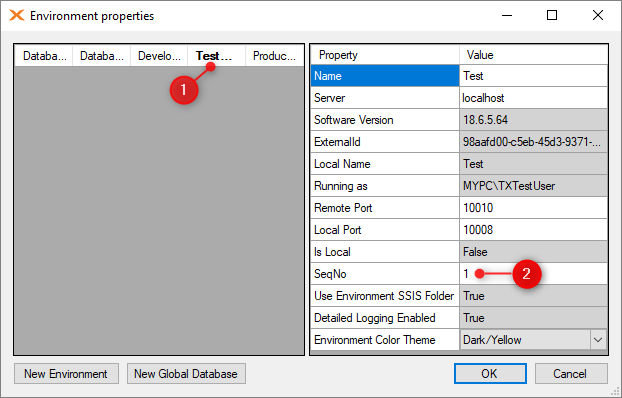

Create Additional Intermediate Environments
If you wish to create additional intermediate environments, you can do so by slightly modifying the previous instructions. For example, if you were to create a Test Environment you would follow these steps.
  1. Be sure to complete initial setup steps for this Environment.
  2. Create the Test Environment in the Test Repository (on the test server, if a separate server is being used).
  3. Create the Remote Production Environment in the Test Repository
  4. Start the Test Service (using the Test Service User)
  5. Create the Remote Test Environment from the Development Repository
  6. Adjust the Environment Sequence numbers by click in the environment name in the environment properties dialog.
