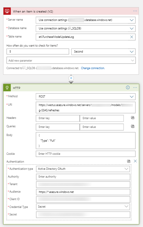

Create the Logic App
In the Azure portal, create a blank logic app, which opens the Logic App Designer.
Finally, create a logic app with a SQL Trigger and the HTTP Action like this:
Note the URI format in the PSOT above:
https://your server region/servers/aas server name/models/your database name/refreshes
