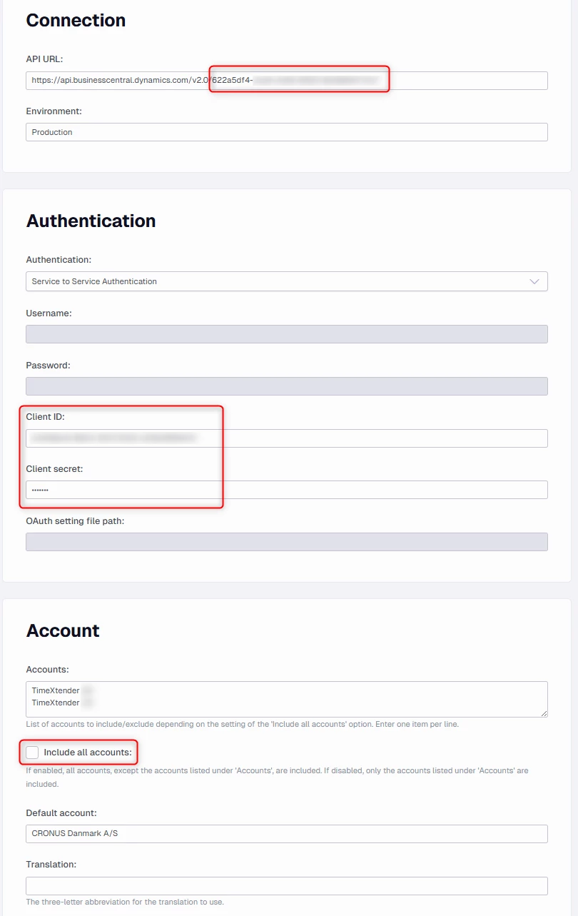

  4. In the API URL field change the https://api.businesscentral.dynamics.com/v2.0/{tenantId} value. Replace {tenantId} with the actual Azure AD Tenant ID which can be found by navigating to the BC environment in https://businesscentral.dynamics.com/, selecting the “?” icon and selecting “Help & Support”. Enter the environment which can also be found in the same location.
  5. You have the following options to authenticate.
    • If the choice is to use OAuth 2.0 authentication, select this option and enter a legitimate file path (e.g. C:\oauth\oauth.txt) for the locally stored OAuth token to authenticate the connection. The text file does not have to be created beforehand, as TimeXtender will create it once you authorize OAuth.
    • If the choice is to authenticate using “Service to Service Authentication” then select this option. To use this, apply the Client ID and the Client Secret from an Application as explained above.
