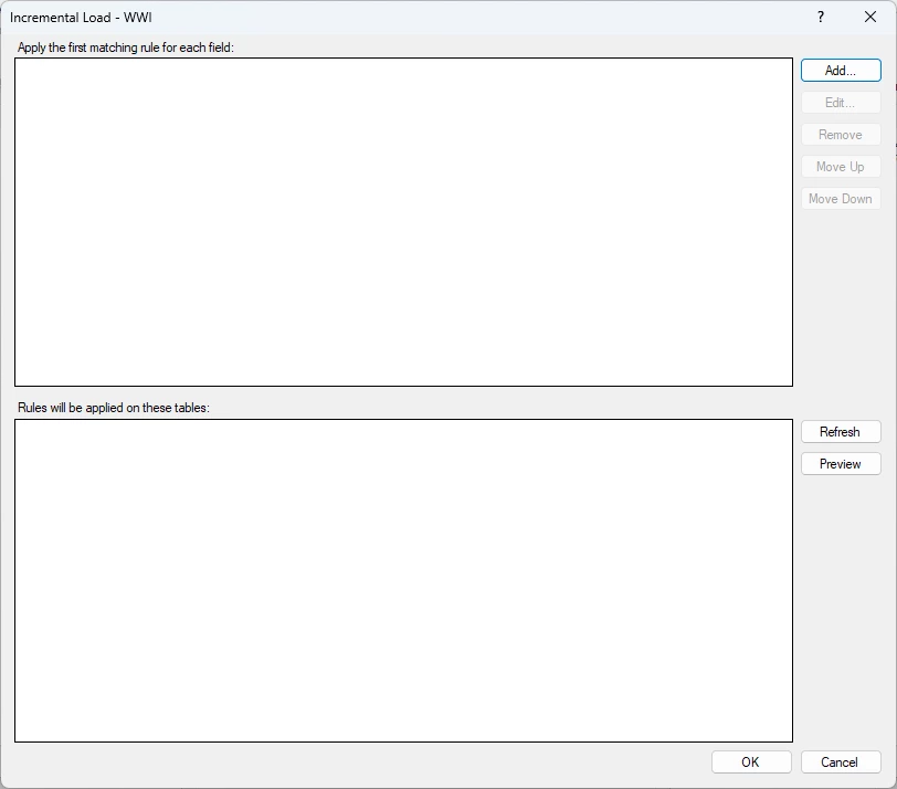

  1. Right-click the data source and click Set Up Incremental Load. The Incremental Load window opens.
  2. Click Add… to
  3. In the Add Incremental Load Setup Rule window, enter the Schema, Table and Column that contains the value the incremental load should be based on. For each item, you can choose different comparison options: contains, equals, not contains, not equals and case-insensitive variants of each. This makes it easy set up a rule that applies across the data source if all tables contains the same  useful incremental column, e.g. “ModifiedDate”.

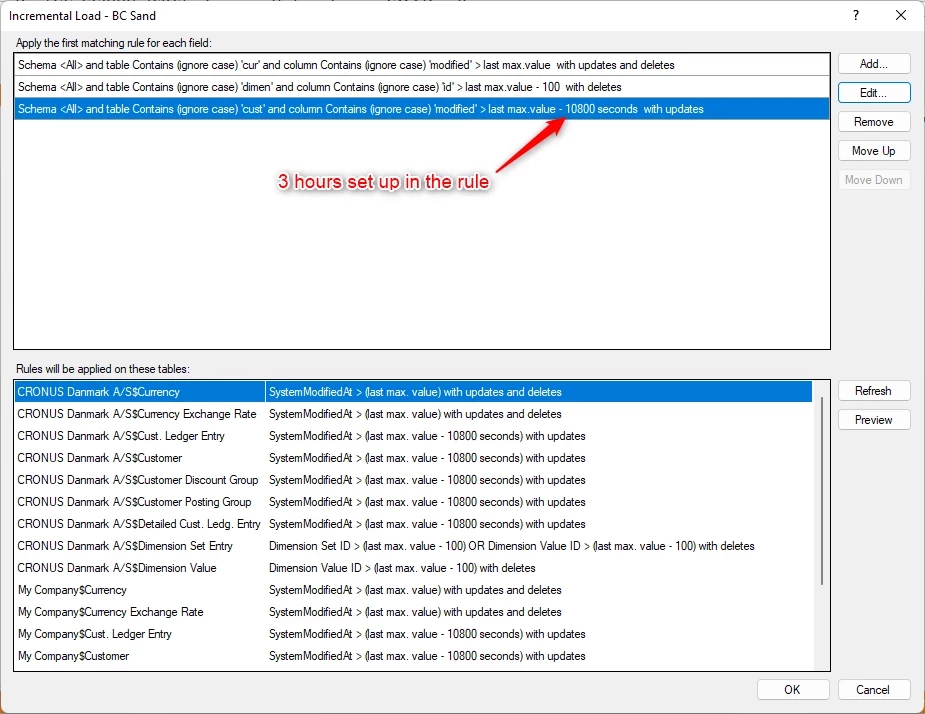

  4. Subtract from value: This option allows subtraction from the field to which the rule applies. This feature is useful for data sources where the modified date is a Date field instead of a DateTime field. Additionally, it can be utilized for data sources with a created date but no modified date, where incremental loading would improve performance. In such cases, incremental loading based on the created date with an offset allows updates to occur on rows recently created, provided the changes happen within the defined interval. The Amount specifies the decrement to apply, which could be on a timestamp or similar field. Time defines the units—Seconds, Minutes, Hours, Days, Weeks, or Years—that will be subtracted from the last added DateTime.

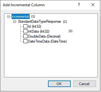

  2. Click Add to add a new incremental value column. Unlike the regular functionality, these columns are explicitly selected for each table, not based on rules.
    • (1) is the endpoint name.
    • (2) is the table name.
    • (3) are the available columns. Only columns that can be used for incremental load will be listed.

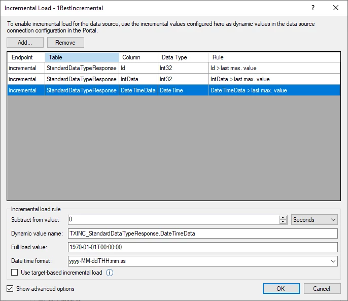

  3. Under Incremental load rule, the options for the selected column are set:
    • Subtract from value: A predefined constant with be subtracted from the last maximum value. For a column with the ‘DateTime’ data type, this is a time value and the granularity can be changed in the right-hand dropdown.
    • Dynamic value name: The dynamic value that has to be used in the data source configuration in order to use the last maximum value. This is the core of how we drive the incremental load for REST data sources. In the TDI Portal this will be the placeholder for the dynamic value and should be written in brackets like, e.g., “{TXINC_StandardDataTypeResponse.DateTimeData}”If you have a subtract value set, the subtracted value is the value we will get in the dynamic value. The name can be changed, but if it is changed it must also be changed in the TDI Portal where it is used.
    • Full load value: The value that will be used for the dynamic value when a full load, or import metadata, is executed. In a incremental load setup for a database data source, it is easy to do a full load - just remove the WHERE-statement from the query. When doing incremental on a REST data source we need a value to include in the query since sending an empty value wouldn’t work.

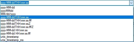

    • Date time format: How to format the datetime when using it in the data source. Only displayed if the column data type is ‘DateTime’. Choose a format from the list or enter your own. In addition to datetime-like formats, you can select ‘unix_timestamp’ and ‘unix_timestamp_ms’ in case the REST data source requires that.
    • Decimal separator: What to use for the decimal separator. Only displayed if the data type supports it.

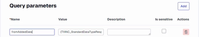

Step 2: Setup in the TDI Portal
The changes required in the TDI Portal will highly depend on the data source that is being connected to. Refer to their documentation on how to extract only the data you need. In the example below, the data source requires you to add a query parameter which tells the REST data source to start from a specific date and get only data that is newer.

I am a bit unclear about setting up the subtraction on an incremental rule. In your explanation:
 Amount is the decrease it will apply to a value applied. This could be on a timestamp or similar. Time is the Seconds, Minutes, Hours, Days, Weeks, or Years it will subtract from the last added DateTime.
In 20.10 incremental loading, we selected a subtraction in time, but no ‘amount’. I am unclear about the ‘decrease it will apply to a value applied’. Could you please elaborate?
Kind regards,
Andrew
  • December 7, 2023
Hi @andrew.gebhard
When you make a rule on a timestamp field it will just be latest value - subtraction amount.
When you make a rule on a DateTime field the subtraction time will be converted to seconds.
It was the same in the old version.
  • Problem Solver
  • December 7, 2023
Or you can apply subtract from value to a numeric field, e.g. include the previous 100 records based on the highest ID.
