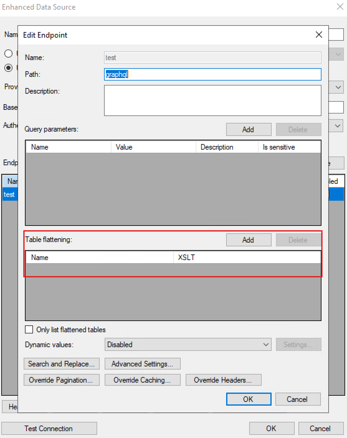

Add table flattening
The first step is to add a flattened table to an endpoint.
  1. Open your data source, expand the endpoint, click Table flattening under Additional configurations and then click Add.
  2. Give your table flattening a name (this will be your resulting flattened table name) and click the Open button to open the table builder interface.

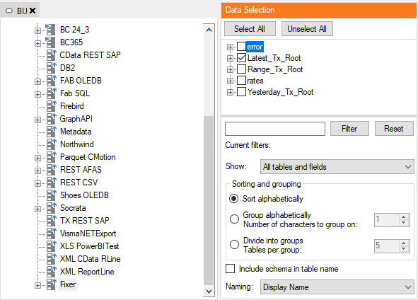

Use XLS to do table flattening
There is a split of the result for this. So if you connect to the latest endpoint you will get the following two tables.
latest_TX_Root and value.

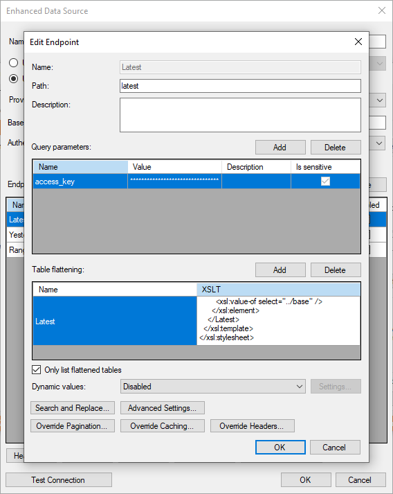

You got the initial first template tag, which looks like this.
<xsl:stylesheet version="1.0" xmlns:xs="http://www.w3.org/2001/XMLSchema" xmlns:xsl="http://www.w3.org/1999/XSL/Transform">
<xsl:output method="xml" indent="yes" />
<xsl:template match="/">
<xbi_root>
<xsl:apply-templates select="/TX_Autogenerated_Root/TX_Autogenerated_Element/rates" mode="rows" />
</xbi_root>
</xsl:stylesheet>
and then you get the second template where you add the fields you want.
<xbi_root>
</xbi_root>
</xsl:template>
<xsl:template match="/TX_Autogenerated_Root/TX_Autogenerated_Element/rates" mode="rows">
<Latest>
<xsl:element name="ALL">
<xsl:value-of select="ALL" />
</xsl:element>
<xsl:element name="DKK">
<xsl:value-of select="DKK" />
</xsl:element>
<xsl:element name="EUR">
<xsl:value-of select="EUR" />
</xsl:element>
<xsl:element name="GBP">
<xsl:value-of select="GBP" />
</xsl:element>
<xsl:element name="AUD">
<xsl:value-of select="AUD" />
</xsl:element>
<xsl:element name="SEK">
<xsl:value-of select="SEK" />
</xsl:element>
<xsl:element name="JPY">
<xsl:value-of select="JPY" />
</xsl:element>
<xsl:element name="ISK">
<xsl:value-of select="ISK" />
</xsl:element>
<xsl:element name="CAD">
<xsl:value-of select="CAD" />
</xsl:element>
<xsl:element name="date">
<xsl:value-of select="../date" />
</xsl:element>
<xsl:element name="timestamp">
<xsl:value-of select="../timestamp" />
</xsl:element>
<xsl:element name="base">
<xsl:value-of select="../base" />
</xsl:element>
</Latest>
</xsl:template>
</xsl:stylesheet>
The only thing you need to look for is that the xsl:apply-templates tag points at the XPath to where the rates start and the same is the match attribute for the second xsl:template tag. I chose to call the table mixRates so I did not have to check the only list flattened tables option, but you can call it Rates to keep it having the same name.
I removed the majority of available symbols (currency types), so I only got those I wanted.
At the bottom, I have added the values missing from the rates table. To connect I use ../ in front of the name. It means select the parent of the current node.
I added it like so

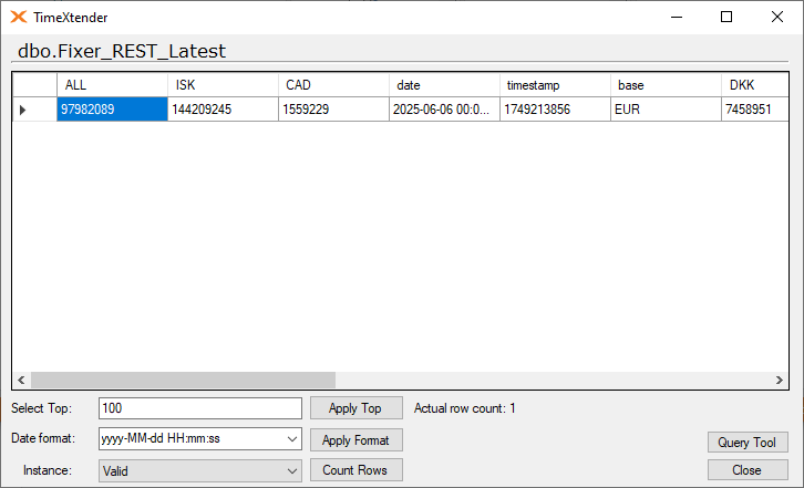

Applying the above XLS code in the XLST field like so will make this Latest table appear.
You can see how it looks here.

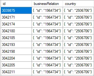

Hi Thomas,
Thank you for the reply. I have tried it and got it to work. However, as I understand correctly, you need to work your way up; the base for your flattened table needs to be the lowest level in the hierarchy. Meaning, if I have a table with a subobject, I take the subobject as the basis for my table. If you have only 1 subobject this is fine, but I have tables with multiple subobjects. Example:
I have a table that contains an id column, and two subobjects; businessRelation and country. If I want to extract this table using a TimeXtender Enhanced connector, I can only choose one subobject for the flattened table? How do I get the above result using table flattening?
  • 1163 replies
  • June 20, 2025
Hi ​@Roos
You can only choose one root node, so it will have to be one of them. You can still add the fields from the country part if you choose businessRelation.
The issue will be how the data is actually structured.
Based on the example you shared I made this
<?xml version="1.0" encoding="UTF-8" ?>
<xsl:output method="xml" indent="yes"/>
<tx_root>
<xsl:apply-templates select="/TX_Autogenerated_Root/TX_Autogenerated_Element/businessRelation" mode="rows"/>
</tx_root>
</xsl:template>
<xsl:template match="/TX_Autogenerated_Root/TX_Autogenerated_Element/businessRelation" mode="rows">
<BusinessRelation>
<xsl:element name="Id">
<xsl:value-of select="../id"/>
</xsl:element>
<xsl:element name="BusinessRelationId">
<xsl:value-of select="id"/>
</xsl:element>
<xsl:element name="CountryId">
<xsl:value-of select="../country/id"/>
</xsl:element>
</BusinessRelation>
</xsl:template>
</xsl:stylesheet>
The issue would be how it could handle if there was more than just one Id in each level, but the above does work for the result you shared.
